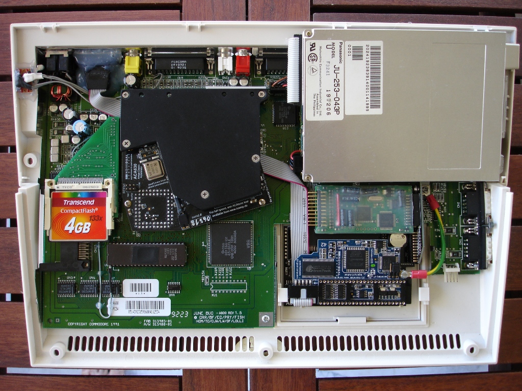

szebb megoldas 1.:
http://4.bp.blogspot.com/-NxUXYMDBmXI/Thv7MIAmTQI/AAAAAAAAAaY/BgZQJSJSsOg/s1600/DSC03 465.JPG
